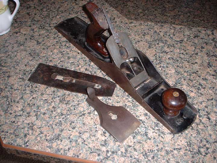

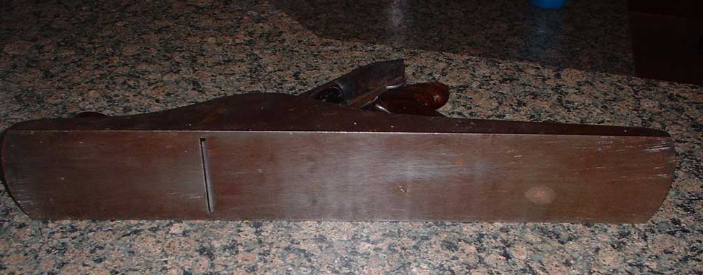

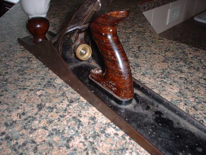

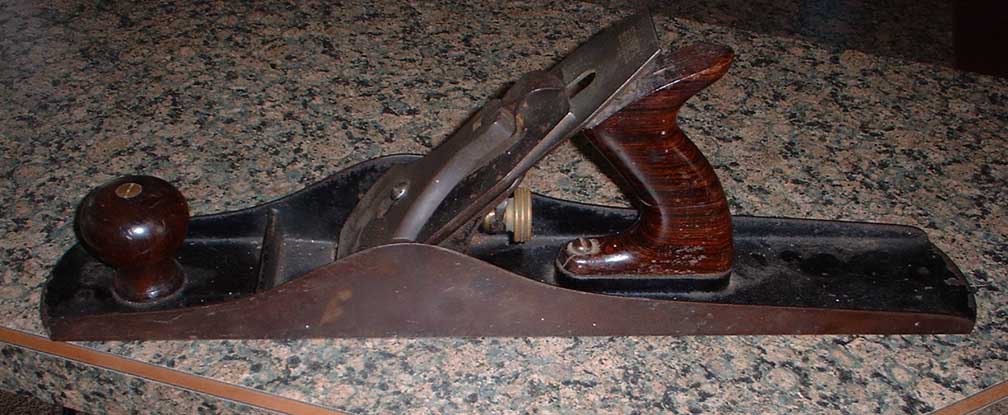

Hey Everyone,
I won this plane off of ebay that Bruce had pointed out for us. Got it for only $10!! This thing is really cool.
But, now what? I have never worked with a old plane, so I don't know how to tune it up. What do I want to do?
Thanks for the help!
Jeff
PostPosted: Sat Jun 17, 2006 8:38 am
Posts: 338
10 bucks, the police may show up at your door any second. I always say you can get em cheap, but you stole that. What should you do. send it to me, thats what..
Seriously, the pictures are a bit dark, but it looks like it is in very nice shape. Do you have a flat plate for sharpening, if not get it. Then I like to hone the surface the blade rest on, the frog, till its flat. No need to make it shine, but it must be flat. I cover the entire surface with red marker and then start out with a course grit paper, say 180 or 220. Sand till the red is gone from everywhere, then remark it and go up in grit till I get too at least 400.
I do the same treatment to the surface of the cap iron where it rest on the blade. You are just concerned that it is flat all across its surface to make good contact with the blade. you will need to lift the back of the capiron up so its face is flat when it sits on the blade.
Now reassemble the plane with the blade slightly recessed, but tight.   Get that marker out and coat the bottom and start the honing process at 10/220 again until the red is gone then go up in grit red each time and try to keep even pressure on it. Some people say you only need the front, the area behind the opening and the rear flat, I don't know I try for as much as possible.
If you find a point where you are having trouble removing the marker from an area go back a grit size or two and do them again. I take it about 1500 sometimes 2000. Then I apply carnuba wax.
As for the blade, which looks to have good life left, I use the scary sharp meathod with a guide, there are lots of ways to do it. But remember to get the back of the blade to, say 1/2 to 1 inch from the cutting surface, again I go to 2000 grit and it has a mirror look.
I am able to shave down to .0015". Some day maybe less then .001".
By the way, the 3rd photo the handle looks like one heck of a nice piece of rosewood. I still can't believe what you payed...Mine cost $30 and I thought I did well. Man I got taken
